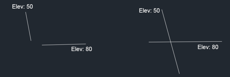

Is it possible to auto extend or trim 2 different polylines to meet at the intersection at different elevations?
Hi everyone, I just joined this community recently and I want to say a big thankyou to y'all for sharing your knowledge and providing help to others. I greatly appreciate it and I have used a dozen lisps posted on this forum.
I'm using Civil 3D and here's my question: Is it possible to extend or trim 2 different polylines to meet at the intersection that are on different elevations? For example, Line 'A' has an elevation of 50, and Line 'B' has an elevation of 80. And I want both lines to meet at the intersection point (from top Plan view) while maintaining their elevation. So in 3D/model view, Line A would be lower than Line B.
So far, I have been using the Extend command to extend Line A to Line B, and then repeating the same procedure for Line B to Line A. This is a repetitive task that I do for hundreds of lines, I hope there's  a solution where I can click on Line A and then click on Line B and both lines will automatically extend (or trim) to meet at the intersection (as observed from the top Plan View). The Fillet command doesn't work for non-coplanar lines (lines with different elevations).
Thankyou for your time.

If you set the system variable EDGEMODE to 1, then you should be able to click on the two lines to extend them.
When starting EXTEND,  do not select boundary edges - just press enter, then click on line A then line B and they should extend to the intersection point.
  • Thanks 1
@eldon This is exactly what I needed. I have been using the Extend tool and I didn't know about this trick. Thanks heaps. I greatly Appreciate it.

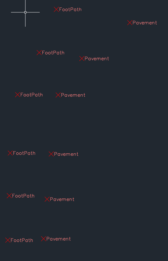

I have one more question that is unrelated to Extending lines and I'm not sure if I should start a new thread for it. Please advise if I should create a different thread for the following question.
I'm using Cogo points in Civil 3D that allows you to input a description for each Cogo point. So, Is it possible to connect the Cogo points together via Line or polyline based on their description? For example, all the points with the same point description ' Foot Path' joins together automatically? Please see attached screenshot.
Civil 3D has a Surveying Database system that requires you to create a new survey database, import the Cogo points into the database to convert them to Survey points and then it'll string the points (with the same description) together. I find that method hardly inflexible and difficult to work with because the survey figure (the survey version of polyline) isn't easy to work with compared to the line and polyline. Any modification to the survey points or figures require you to update the survey database to reflect the change.

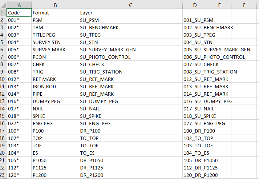

We have been using CIV3D for years and always auto strung the strings, we have around 270 codes in the "Description key sets". Some of these projects have in excess of 10,000 points.
You just need a DWT that has the keys set up in it, there are basically 2 a numeric or a Alpha key set with a few that are both TR6 Tree 6m dia.
Do you have access to a DWT that is set up ? If not we need to know what your codes look like. Ask who you bought the Civ3d from they should have some.
Ok now for the real big news, in CIV3D you can export the Description keys but you can not import, so I wrote one it reads a excel csv with all the details and makes description keys.

@tombu Thanks for the reply. Just to clarify, I'm not working with survey field data. I have to manually put in each coordinated Cogo point (from old plans) and then join them together. Hence I'm asking if there's an easier way to join Cogo points together based on their assigned point description.
@BIGAL Thanks for the reply. Yes, I have set up a point description system for other things that automatically change point symbol based on its description. Though the point description function doesn't join points together into a line or polyline.
@hosneyalaa Thanks for the reply. I'm using Civil 3D to create the Cogo points and assigning each Cogo point with a description. So I wonder if it's possible to join the Cogo points together (points with the same description) without using the survey database's 'line work figure', which as I have pointed out - isn't intuitive and not easy to work with.
Currently, I have to use the polyline tool to snap to each Cogo point to form a line. That Or I'll have to create a new survey database to connect the points together. By importing the Cogo points into the survey database to convert them to survey points, which would create a survey duplicate of all the points. And if were to modify the Cogo points, I would need to re-import the Cogo points back into the survey database again to update the figure line work.
@hosneyalaa Here's the example Civil 3d point file. Please see attached file. Thanks!
Thanks again everyone for your replies. Have a good day.

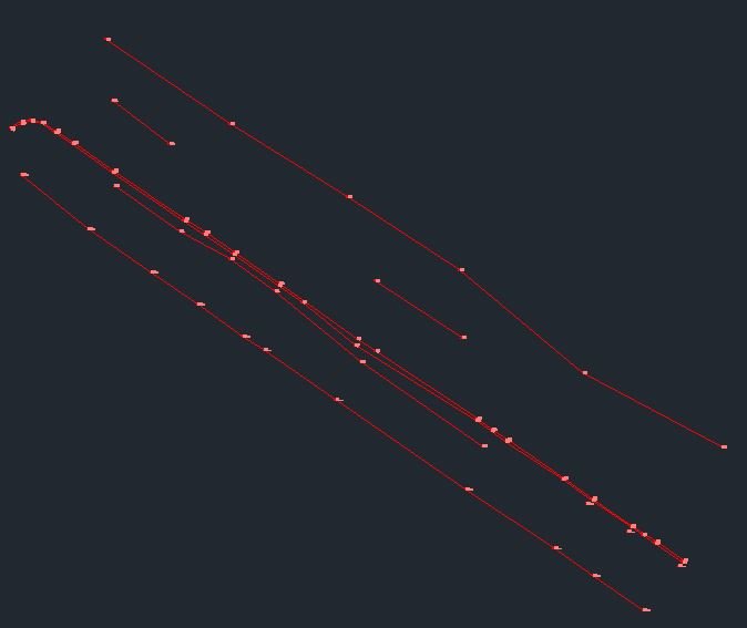

hi
try this

@hosneyalaa Thank you so much. The script works like a charm and very intuitive. Though after creating the lines, I checked in the object viewer and the new lines have 0 elevation. Is it possible for the line to inherit the Cogo point's elevation that it connects to? Currently, the lines are flat and don't have height information from the Cogo points.
Have a good day and I greatly appreciate your help. You're very talented.
